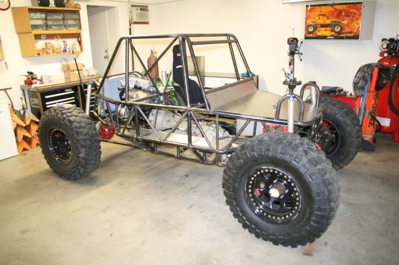

« Reply #86 on: December 19, 2011, 01:17:05 AM »
It's finally a rolling chassis!

« Reply #87 on: December 19, 2011, 10:45:05 AM »
awesome dude. that looks sweet.
« Reply #88 on: December 19, 2011, 11:34:21 AM »
KOH here you come  Grin

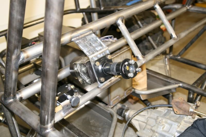

« Reply #91 on: January 08, 2012, 02:39:18 AM »
still whittling away at it.
made a brake pedal:
steering column
radiator mounts
intermediate shaft:
gas tank:
