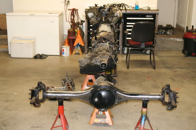

H233 front axle:
KovemaN
Posts: 32
« Reply #33 on: September 26, 2011, 01:27:44 AM »
Interesting.  Did you flip it and weld on some d44 inners?
« Reply #34 on: September 26, 2011, 01:41:04 AM »
Yup.  I wanted to do a 9" with 60 outers, but Zach was kind enough to donate his old axle.  Since I have the Waggy outers already I figure this would be worth a try.

Just noticed the now front pumpkin is upside down.  Is that going to cause any oil starvation problems on the pinion/bearings?  I can't remember if there's a slinger in there.
Not all who wander are lost.
« Reply #48 on: October 13, 2011, 12:02:07 AM »
I need to research some more on what mods to do for pinion oiling.  I'm not even sure if the rear engine KOH buggies run flipped axles or reversed rotation motors?
