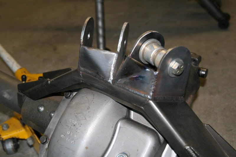

rear 4 link bracket

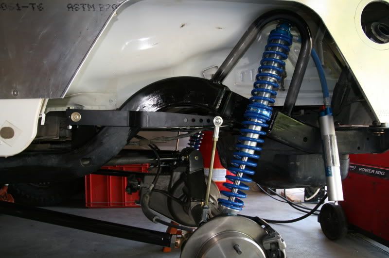

« Reply #11 on: August 04, 2011, 09:02:17 PM »
rear four link, antirock, coilovers mounted.

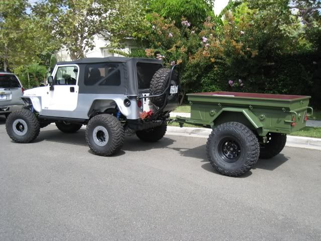

new trailer:
« Reply #19 on: September 12, 2011, 10:14:09 AM »
That's awesome.  Did he bring you the trailer and you did work on the leaves or something?  Is this setup on 35's?
