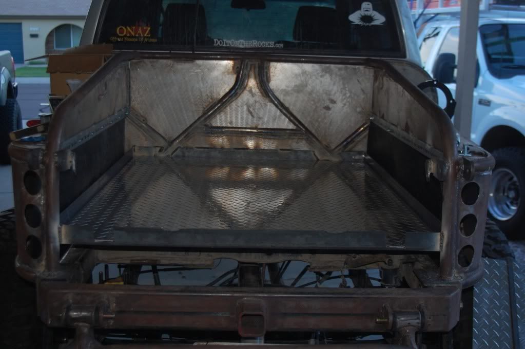

got some of the holes cut out for the lights ,  the bigger lights will be centered on the back of the tire carrier with the licence plate , still need to make a mount for the gas can and buy some straps for the C02 tank

almost done with the outside , still need to weld the panels the rest of the way on then ill start on the wheel wells then the floor

i ran out of wire but got the panels mostly welded in for the front portion of the bed , took forever to get each piece fitted in their place
also the bed in now bolt on

didnt get much done today because i wasnt feelin great but got some chains installed for stops on the tire carrier
need to buy some bolts for the lugs to bolt onto then the carrier will be done

« Reply #32 on: August 10, 2010, 07:03:38 PM »
i dont think ill have any problems  , the tire carrier at its lowest is even with the frame
before i would drag the bumper on certain things but not many and that sat quite a bit lower than the frame

well i havent had much time to work on the truck lately , been working 50-60 hours a week but i made some time this weekend
got the floor for the bed pretty much done , need to finish welding it up then fit the gas tank in there
once thats done bed will come off get cleaned up then go to powdercoat , im so ready to get this thing done

not much of an update , one last test fitting after cleaning up the welds
floor is all done  with welded nuts underneath for easier mounting , today just need to drill the holes for the all thread so i can test mount the gas tank then the bed comes back off and goes to powdercoat monday !!
